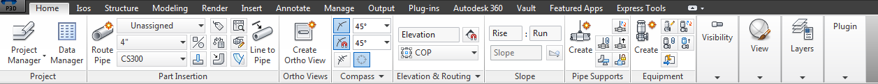

The 3D Piping Home tab contains panels with the commands that you need to create and modify a piping model. This tab includes the following panels:
The 3D Piping Home tab is part of the 3D Piping workspace.

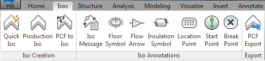

The Isos tab displays options for working with isometrics. This tab includes the following panels:
The Isos tab is part of the 3D Piping workspace.

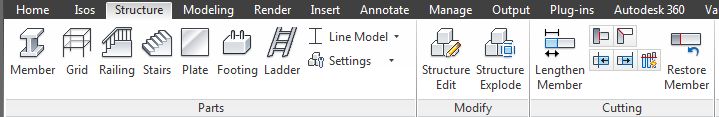

The Structure tab displays options for working with structures. This tab includes the following panels:
The Structure tab is part of the 3D Piping workspace.

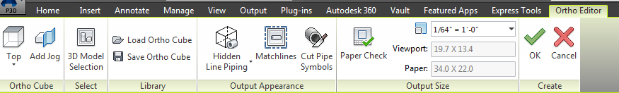

When you enter the specialized orthographic environment by clicking the Create Ortho View button on the home tab, a contextual ribbon tab is available. It contains commands specific to the ortho editing environment. The contextual tab is closed when you exit that environment.
The Ortho Editor tab displays options for working with orthographic view configurations. The tab includes the following panels:
The Ortho Editor contextual tab is part of the 3D Piping workspace.

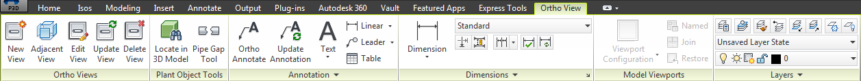

When you enter the specialized orthographic environment by creating or opening a drawing on the Orthographic DWG tab of the Project Manager, this special contextual ribbon tab is available. It contains commands specific to the ortho view environment. The contextual tab and associated panels display in green to provide visual feedback that you are in a specialized environment. The contextual tab is closed when you exit that environment.
The Ortho View tab displays options for working with orthographic drawings. The tab includes the following panels:
The Ortho View contextual tab is part of the 3D Piping workspace.

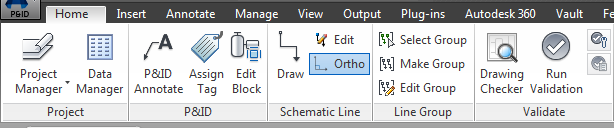

The P&ID Home tab displays options for working with P&ID drawings. This tab includes the following panels:
The P&ID Home tab is part of the P&ID PIP, P&ID ISO, P&ID ISA, P&ID DIN, and P&ID JIS/ISO workspaces.
