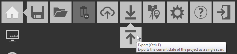

ReCap Pro also allows you to export the scan project as a single file. This option is also accessible through the main menu:
You can export the scan in a number of different file types. These include: E57 (Pro only), PTS, PCG, & RCP/RCS.
