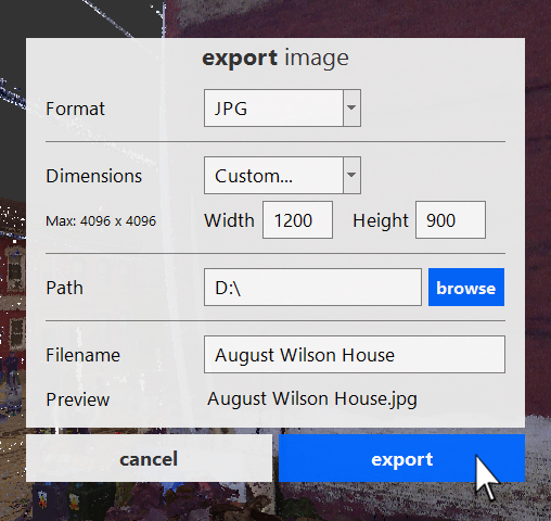

Capture the screen view of a model in either JPEG or PNG format for export as an image to use in presentations or documents.
You are prompted with a dialog to adjust the settings of your image export.
Choose your preferred file format, as well as dimensions, file path and name. Once exported, your files are available at your predefined destination.

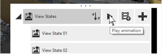

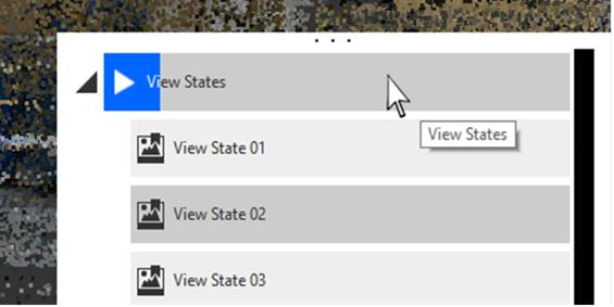

Playback is initiated through the Play button found on mouse-over of the group entry in the Project Explorer. Once playback has been started, ReCap automatically cycles through the View States contained within that group, from top to bottom as they appear in the Project Explorer.
New View States can be added, removed, or moved in the View State list to extend or modify the animation result. Because we are utilizing the standard animations for View States, it's best to think of individual View States as key frames that the animation toolkit will use to move the user through the project.

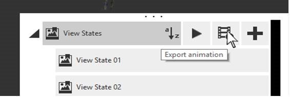

Exporting animations as videos is also accessible through the contextual UI of group headers for Pro subscribers.

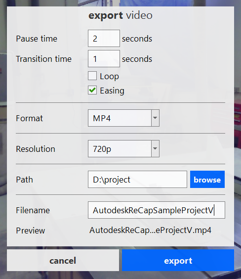

Current export options allow for MP4 or AVI formats, with 720p, 1080p, or 4k resolution. You can also choose to "loop" your video and toggle the use of an easing in transitions between View States. Turning easing off will create a constant speed of travel between each View State
Once exported, the video provides a crisp, full resolution visualization of the point cloud, omitting any transition artifacts that may be present when viewing the animation within ReCap.
