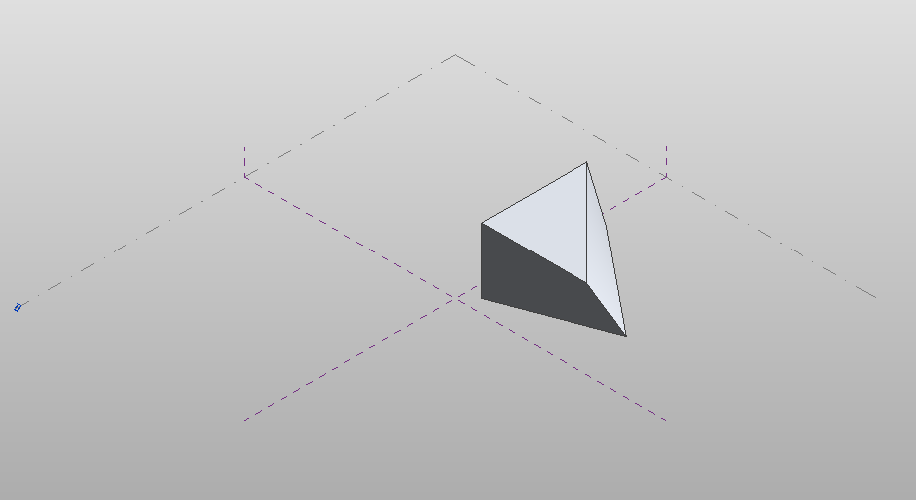

Figure 56: Resulting extrusion form

The following example moves the first profile curve of the given form by a specified offset. The corresponding figure shows the result of applying this code to the loft form from the previous example.
Code Region 14-5: Moving a profile
public void MoveForm(Form form)
        int profileCount = form.ProfileCount;
        if (form.ProfileCount > 0)
                int profileIndex = 0;   // modify the first form only
                if (form.CanManipulateProfile(profileIndex))
                XYZ offset = new XYZ(-25, 0, 0);
                form.MoveProfile(profileIndex, offset);
Figure 58: Modified loft form
The next sample demonstrates how to move a single vertex of a given form. The corresponding figure demonstrate the effect of this code on the previous extrusion form example
Code Region 14-6: Moving a sub element
public void MoveSubElement(Form form)
                int profileIndex = 0;   // get first profile
                ReferenceArray ra = form.get_CurveLoopReferencesOnProfile(profileIndex, 0);
                foreach (Reference r in ra)
                        ReferenceArray ra2 = form.GetControlPoints(r);
                        foreach (Reference r2 in ra2)
                                Point vertex = document.GetElement(r2).GetGeometryObjectFromReference(r2) as Point;
                                XYZ offset = new XYZ(0, 15, 0);
                                form.MoveSubElement(r2, offset);
                                break;  // just move the first point
Figure 59: Modified extrusion form
