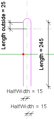

Learn how to model a single loop connector family for solid walls.
The single loop connector family can be used in multiple loop families. This example is a metric family, but you can create Imperial versions similarly.
Forms panel
(Sweep).
Sweep panel
(Sketch Path).
Properties panel
(Family Types).
Dimension panel
(Aligned).
Sketch Path tab
Mode panel
(Finish).
Sweep path
(Select Profile).
Sweep path
(Edit Profile).
Draw path
(Circle).
Properties panel
(Family Types).
Dimension panel
(Diameter).
Edit Profile
Mode panel
(Finish).
Mode panel
(Finish).
Properties panel
(Family Types).
The loop connector family is ready to save and load into your multiple loop connector families.
