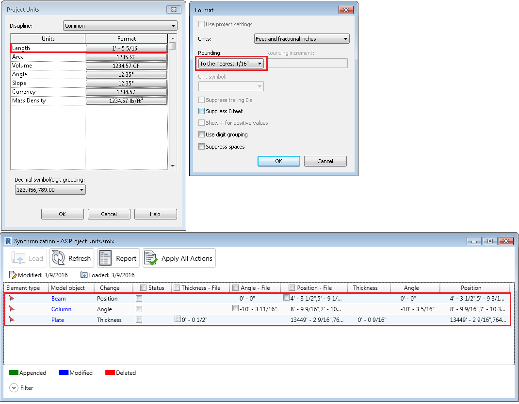

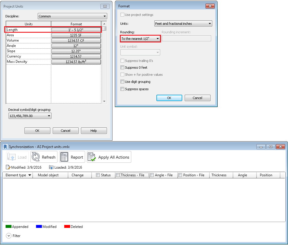

Synchronization and Project Units
The Synchronization dialog works with the units and tolerances set in the Revit Project Units dialog.
You can manage the number of modified lines that are displayed inside the synchronization dialog by modifying the unit tolerance in the Project Units dialog.

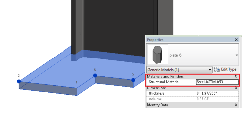

  • Material
In the following example the base plate material was modified to "Steel ASTM A53" in Advance Steel. This modification was then synchronized in the Revit project. The difference is spotted as a material change. If the modification is applied, the plate material is changed according to the new value.
