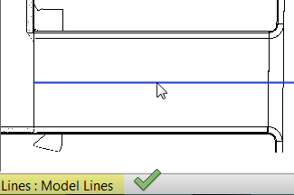

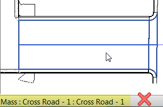

Solution: Move the cursor in the view until it highlights an item. Check the message in the status bar; it indicates the category, family, and type of the item.
If the status message indicates that the highlighted item is from the Topography or Mass categories, do not click to select the item.
Instead, move the cursor closer to the host line for the element to modify. Zoom into the view, if needed, or press Tab to cycle through nearby elements. Watch the status message. When it displays "Lines : Model Lines" or "Lines : Detail Lines," click to select it.
When you successfully select a host line, the Modify dialog presents a list of functions.
