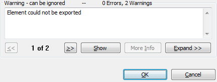

| Warning for elements that cannot be exported. | ![]() |
This warning message is displayed when the extension is not able to export an object to the SMLX file. The object that is causing the export to fail is highlighted in the model. You can abort the export process, delete the object, and export the model again. |

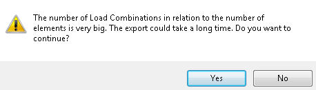

| Warning for time exceeding export process. | ![]() |
The Advance Steel Extension for Revit exports the structural analysis results from all the load combinations. This warning message is displayed to inform you that the export process may take longer than expected. This happens because of the large number of load combinations in the Revit model. You can choose to abort the export process, make a back-up of the model, delete all the load combination cases that don not matter in the analysis, and export the model again. |
