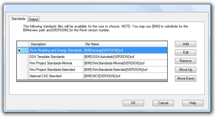

Standards
Within here you can add existing checks (*.bcf), edit the description (friendly name) and/or order displayed.  When saved this is how it will be displayed in the predefined lists for the Check and Manage drop downs.  This is saved in the Model Review.config file located in the installation folder, for use with multiple users this will need to be copied to the users installation folder to get the same configuration.

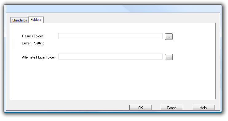

Folders
The Results Folder is used to store the output when using batch processing.  If you are using a network location, be sure permissions allow access to write files.
Current Setting provides the location of the output folder.
Alternate Plugin Folder allows expanded functionality to be given to Autodesk Revit Model Review.
