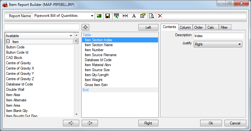

Use the Item Report Builder dialog to create new reports or customize existing reports.

The Item Report Builder dialog displays.

The dialog is organized into four main areas. The top section is used to select the report currently being worked on, and also contains various options associated with the file. The leftmost section contains a list of all the Print Objects that it is possible to display on this type of report (the list will vary for the different kinds of reports). The middle column shows the actual layout of the report, and the right hand column shows the details of the particular Print Object highlighted in the middle column.
Several pre-configured reports are available from the Report Name drop-down menu. Once selected, the report can be customized. Changes made to the report can be previewed before accepting by clicking Print Preview
from the toolbar.
