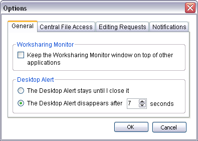

Review the options that are available on the General tab in Worksharing Monitor.
Use options on the General tab to specify the following:
- Whether the Worksharing Monitor window always stays on top of other application windows. This option makes sure that you see new information as it becomes available.
- If you use desktop alerts (specified on the other tabs), how long they display on the Windows desktop.
