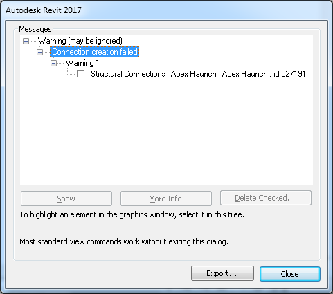

A Show Related Warnings button becomes available in the Modify | Structural tab
Framing panel, when you select the fabrication shape or the detailed connection. This button appears if the structural connection encounters an error after it is calculated.
(Structural Connection) tool, click Connection to expand the drop-down menu. Select Show warnings on views.

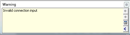

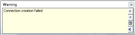

Warning messages appear when:

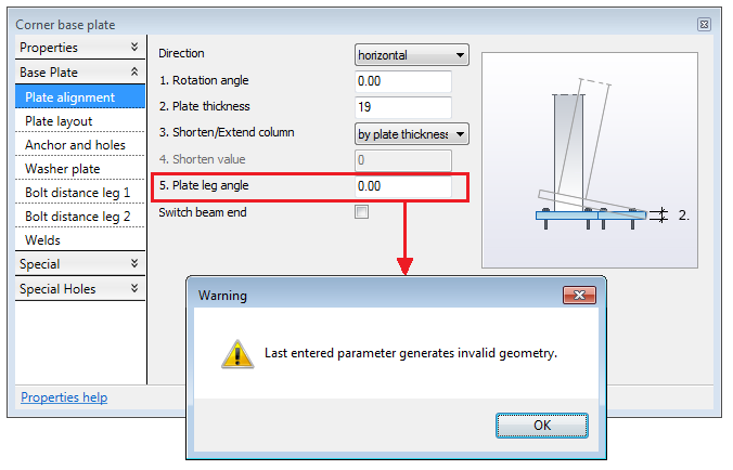

An example of such a unique situation is the Round slot end option, from the Tube connection with sandwich plate connection dialog, created on a circular hollow section brace.
