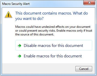

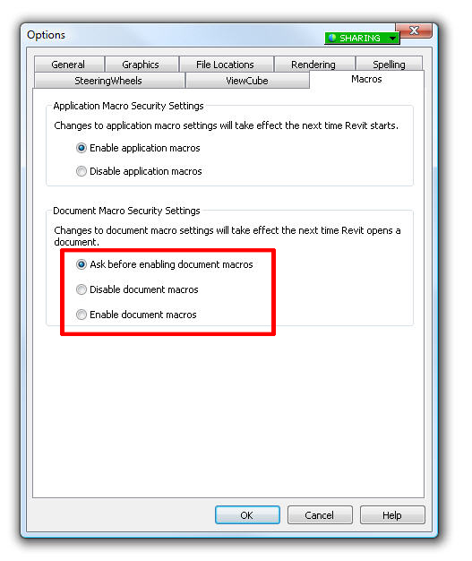

- Macros - When running on folders you might be prompted with a dialogue box for each file similar to the following:
