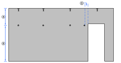

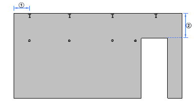

| Type | Specifies the lifting anchor and type for the precast wall. |
Minimum Distance to Edge
Specifies the minimum distance from the lifter to either edge of the wall. |
Minimum Top Distance to Opening
Specifies the minimum distance from the top of a lifter to any opening in the wall. |
| Tension Capacity | Specifies the rated tensile strength of the lifting anchor. |
| Side Lifters if Height Exceeds | Specifies the minimum wall height required before placing side anchors in the precast wall. |
Bracing Inserts
| Type | Specifies the bracing and type for the wall connection. |
Distance Bracing Inserts
and
Specifies the location of wall bracings as a distance from the upper edge or lower edge of the wall. |
| As Percentage of Wall Height | Select to use a percentage of the total precast wall height instead of specific units for the Distance Bracing Inserts parameter. |
| Position Bracing Inserts | Specifies where bracing inserts are placed. Select either None, On View Side, Opposite to View Side, or Both Sides. |
| Minimum Distance to Opening | Specifies the minimum distance from the bracing to any opening in the wall.
