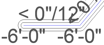

When using Site Designer to modify elements of the site design, change the view scale when text annotations (such as values for slope and elevation) are too large or too small.
For example, if you are changing the elevation of points for a site element, you may want to adjust the view scale temporarily so the values are readable.

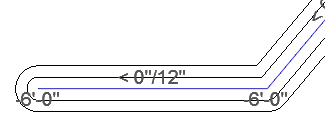

The Change View Scale tool on the Site Designer Modify dialog does the following:
To change the view scale for site elements
The size of text annotations in the view adjust accordingly.
Now you can make other changes to the selected site element.
Otherwise, clicking Apply will change the view scale in the project, and the change is reflected on the View Control Bar.
