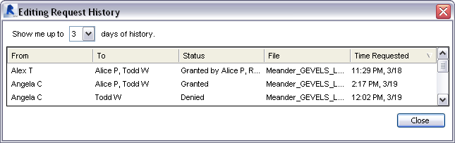

The Editing Request History pane in Worksharing Monitor lists requests that have been granted, denied, and retracted.
To see the list of requests, click
(History) in the upper-right corner of the Editing Requests pane.
The Editing Request History dialog can display up to 5 days of information about editing requests.
