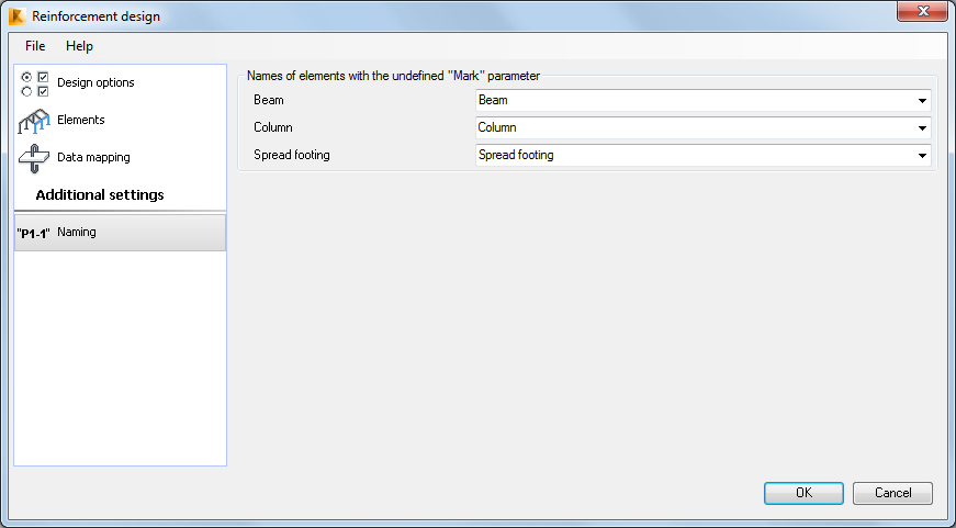

The Naming tab is available for design and verification modes. It applies only to elements for which the Mark parameter is not defined. Use it to define a name prefix for Robot RC elements.
