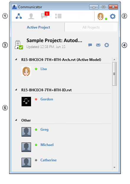

The following image identifies the main areas of the Communicator window.
Click a view icon to:
(My Projects)
(My Contacts)
(Chat)
A number badge displays on the Chat icon to notify you of new chat messages or system messages.
(Timeline)
Access preferences by clicking your
BIM 360 Team account picture, and the Settings icon:
to change the
Communicator window display setting and startup preference.
The name of the project and last-updated date and time display.
Icons to the right of the project name allow you to:
To send a private chat message to a contact, double-click a contact in the list of project members.
The main area of the window changes based on the selected view. In this example, the Project view is selected showing members and model activity for the current project.
