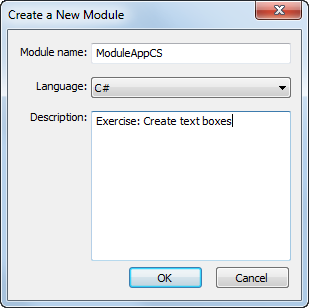

- In the Create section of the Macro Manager dialog, click Module.
The Create a New Module dialog opens.
- Enter the following information:
- Enter a name in the Module name field.
- Select either C#, VB.NET, Ruby, or Python in the Language field.
- Optionally, add a brief description of the module in the Description field.
Creating an Application-level module in C#
- Click OK.

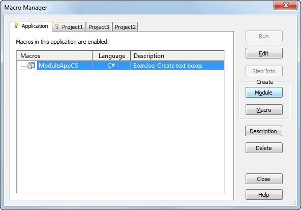

The new module is created and listed in the Macros Manager. One or more macros may now be added.
