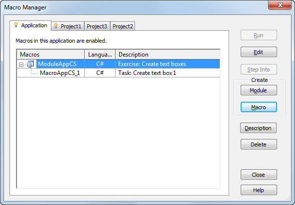

- In the Macro Manager, select the Application tab (for application-level macros) or a Project tab (for document-level macros) where the macro will be placed.
- In the Create section of the Macro Manager dialog, click Macro.

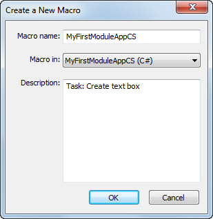

The Create a New Macro dialog opens.
- Enter the following information:
- Enter a name in the Macro name field.
- Select a parent module from the Macro in list. The language of the parent module will define the language of the macro.
- Optionally, add a brief description of the macro in the Description field.
- Click OK.
The new macro is placed in the parent module in the Macro Manager.

- Click Description to view a description of a selected module or macro in its entirety. This is useful when the Description column of the Macro Manager is truncated.
