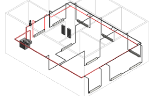

- MEP fabrication modeling:
- P&ID Modeler for Revit (2018.2): Model piping faster and more efficiently using P&IDs from a Plant 3D Collaboration project directly within
Revit. See
P&ID Modeler.
- Direction arrows for MEP connectors (2018.2): When you use the Connect Into tool or select connectors when placing analytical pipe connections, connector arrows on mechanical equipment now display flow direction.
- Flow and pressure drop calculations for hydronic piping networks (2018.2):
- Analytical pipe connections: To calculate flow and pressure drop in a piping network before physical connections have been made, you can add an analytical connection between mechanical equipment and piping. See
Add Analytical Pipe Connections.
- Flow and pressure drop calculations: To improve performance,
Revit can perform flow and pressure drop calculations for hydronic closed loop networks as a background process. Use the Mechanical Settings dialog to enable the new method. See
Specify Calculation and
Background Processes.
