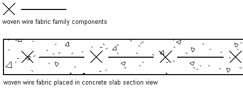

    The following image shows the addition of a welded wire fabric family to a concrete slab in section view.
