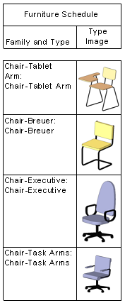

This example illustrates how to include images in a furniture schedule, but you can use the same procedure to include images in other types of schedules.
VIdeo: Creating a Furniture Schedule with Images
Note: This video was recorded using Revit. When performing the procedures using Revit LT, you may notice minor differences in functionality and user interface.
  1. Add furniture elements to the model, for example several types of chairs.
  2. Select a furniture element in the model, and click Modify | Furniture tabMode panel (Edit Family).
  3. Open the Family Types dialog, and under Identity Data, click in the Type Image field, and click the browse button to open the Manage Images dialog.
  4. Click Add, and navigate to the location of the image you wish to associate with this furniture family.
  5. Select the image, and click Open.
  6. Click (Load into Project) to load the family back into the model and overwrite the existing family and parameters.
  7. Repeat steps 2-6 for each furniture family you placed in the model.
  8. Create a Furniture schedule, and include the Family and Type, and Type Image fields.
  9. Create a sheet view and place the furniture schedule on the sheet. The furniture images display in the schedule viewport placed on the sheet.
