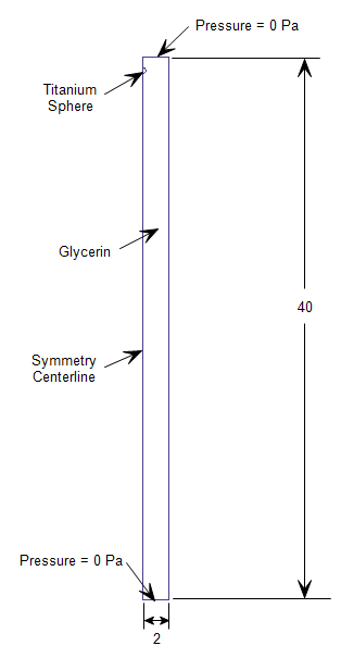

Geometry and Boundary Conditions
All dimensions are in meters:
The model was solved as axisymmetric.
