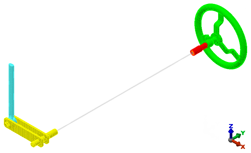

Home
icon immediately above the ViewCube for an isometric view of the model.
The model should look like the following image:
Save on the Quick Access Toolbar (QAT) to save your model.
This tutorial is now complete. You can use the meshed model to complete the Remote Crank Static Stress Analysis tutorial.
