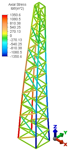

Now, we view the axial stress results.
Results Contours
Stress
Beam and Truss
Axial Stress. The model displays the in-phase results of the first frequency, where the axial stress varies between approximately +/- 1,351 psi.
