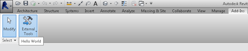

The Autodesk Revit API enables you to add new commands to the user interface of Autodesk Revit. These commands will appear in the Add-ins tab under the 'External Tools' pulldown, as seen in Figure 1. Through the API, external tool commands have access to the Autodesk Revit database, as well as the currently selected elements.
Figure 1: External Tool added to Revit

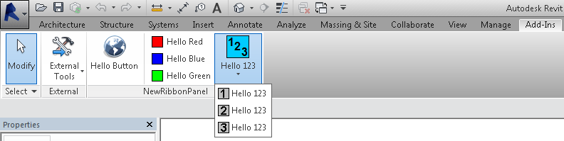

The Autodesk Revit API enables you to also add external applications. These applications are invoked during Autodesk Revit startup and shutdown. They can create new panels in the Add-ins tab, as seen in Figure 2. They can also register handlers that can react to events occurring in the Autodesk Revit user interface.
Figure 2: New panels and controls added to Revit
