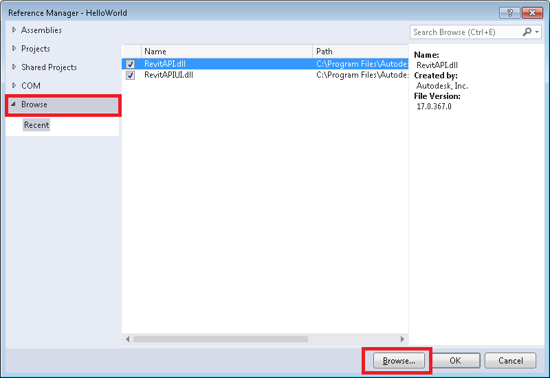

    Figure: Reference Manager
  3. In the Reference Manager dialog box, click the Browse tab, then click the Browse button.
  4. Locate the folder where Revit is installed and click the RevitAPI.dll. For example, the installed folder location might be C:\Program Files\Autodesk\Revit 2018.
  5. Click OK to add the reference.
  6. Repeat steps above to add a reference to RevitAPIUI.dll, which is in the same folder as Revit API.dll.

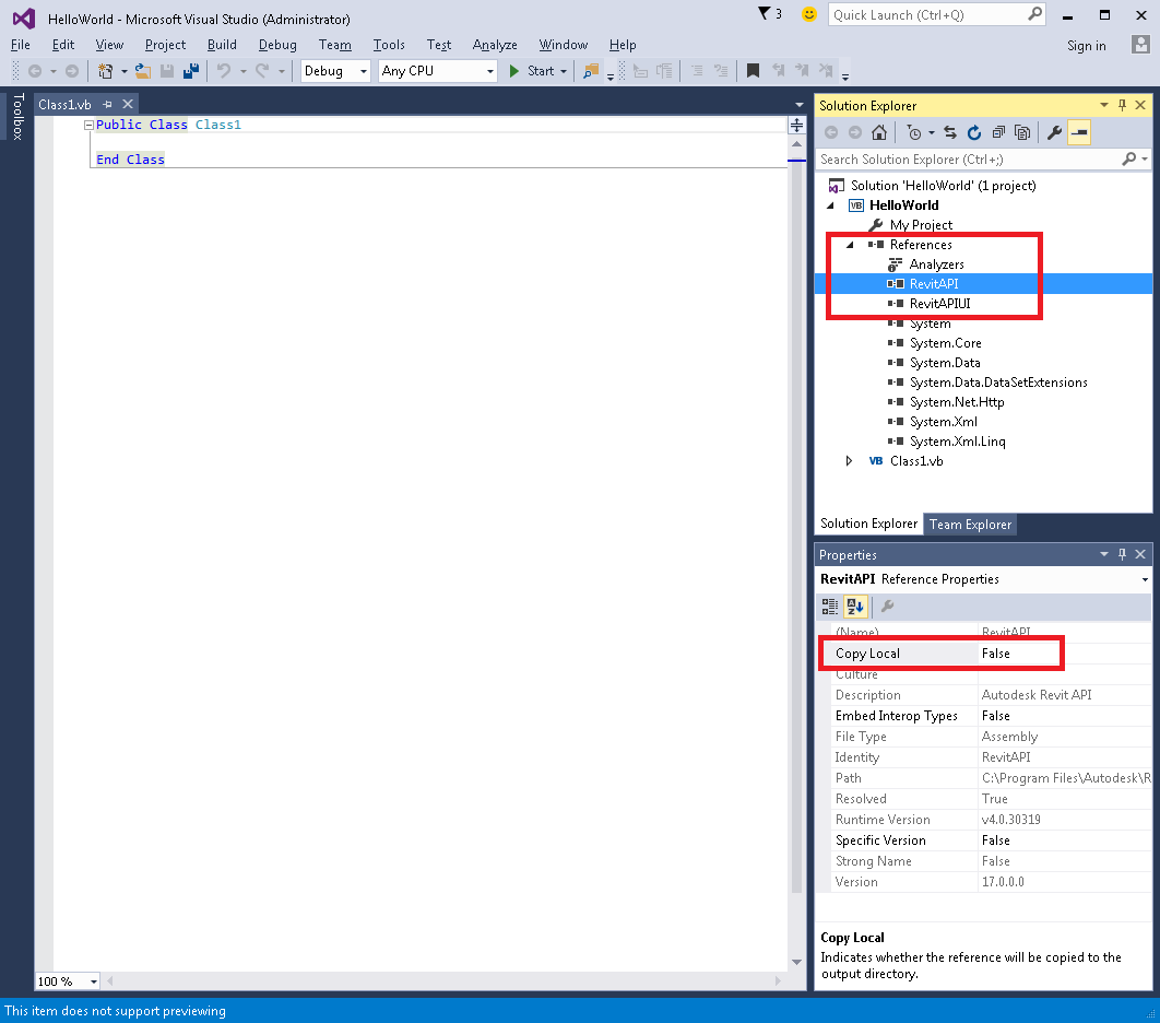

    Figure: Add references
  7. Click OK to close the Reference Manager dialog.
  8. To complete the process, click RevitAPI under References in the Solution Explorer. Set Copy Local to False in the Properties frame. Repeat for RevitAPIUI.
