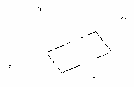

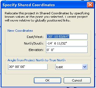

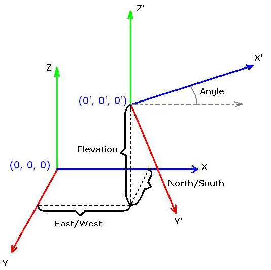

Project position is an object that represents a geographical offset and rotation. It is usually used by the ProjectLocation object to get and set geographical information. The following figure shows the results after changing the ProjectLocation geographical rotation and the coordinates for the same point. However, you cannot see the result of changing the ProjectLocation geographical offset directly.
Figure 125: Point coordinates
Note: East indicates that the Location is rotated counterclockwise; West indicates that the location is rotated clockwise. If the Angle value is between 180 and 360 degrees, Revit transforms it automatically. For example, if you select East and type 200 degrees for Angle, Revit transforms it to West 160 degrees.
Figure 126: Geographical offset and rotation sketch map

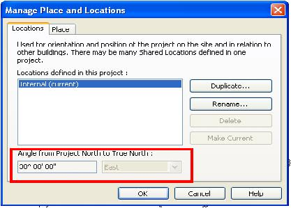

Note: There is only one active project location at a time. To see the result after changing the ProjectLocation geographical offset and rotation, change the Orientation property from Project North to True North in the plan view Properties pane.
Figure 128: Project is rotated 30 degrees from Project North to True North
Figure 129: Project location information
