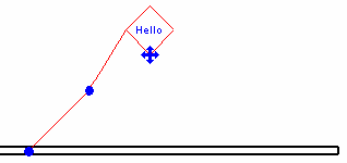

Note: Note that IndependentTag.Create only works in the 2D view or in a locked 3D view, otherwise an exception is thrown. The following code is an example of IndependentTag creation. Run it when the level view is the active view.
Note: You can't change the text displayed in the IndependentTag directly. You need to change the parameter that is used to populate tag text in the Family Type for the Element that's being tagged. In the example below, that parameter is "Type Mark", although this setting can be changed in the Family Editor in the Revit UI.
Code Region 16-5: Creating an IndependentTag

    // newTag.TagText is read-only, so we change the Type Mark type parameter to
    // set the tag text.  The label parameter for the tag family determines
    // what type parameter is used for the tag text.
    WallType type = wall.WallType;
    Parameter foundParameter = type.LookupParameter("Type Mark");
    bool result = foundParameter.Set("Hello");
    // set leader mode free
    // otherwise leader end point move with elbow point
    newTag.LeaderEndCondition = LeaderEndCondition.Free;
    XYZ elbowPnt = wallMid + new XYZ(5.0, 5.0, 0.0);
    newTag.LeaderElbow = elbowPnt;
    XYZ headerPnt = wallMid + new XYZ(10.0, 10.0, 0.0);
    newTag.TagHeadPosition = headerPnt;
    return newTag;
Figure 74: Create IndependentTag using sample code
