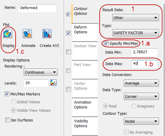

Plot the Safety Factor
Refer to
Figure 1 – 1.c
for the following four steps.
Figure 1 – 1.c
From the
Result Data pull-down menu, choose
Other, and set
Type to
SAFETY FACTOR.
Activate the
Specify Min/Max checkbox.
Type
40 into the

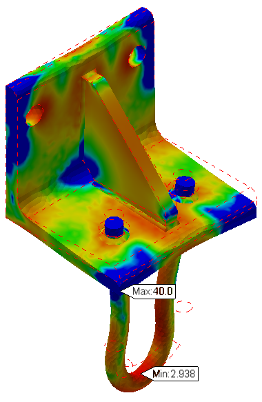

Data Max input field. This value produces a fuller, and more meaningful, color spectrum on the contour plot.
Tip: The actual maximum safety factor is many times greater than the minimum value, which skews the contour color towards red for most of the model. Reducing
Data Max, which reduces the range of the plot legend, eliminates the skewed contour problem. Resolution is lost at the higher safety factor values, which appear as dark blue (in this case, those over 40). This is inconsequential, since the low safety factor values are the ones of interest.
Click
Display. Your safety factor contour plot should be similar to the following image:

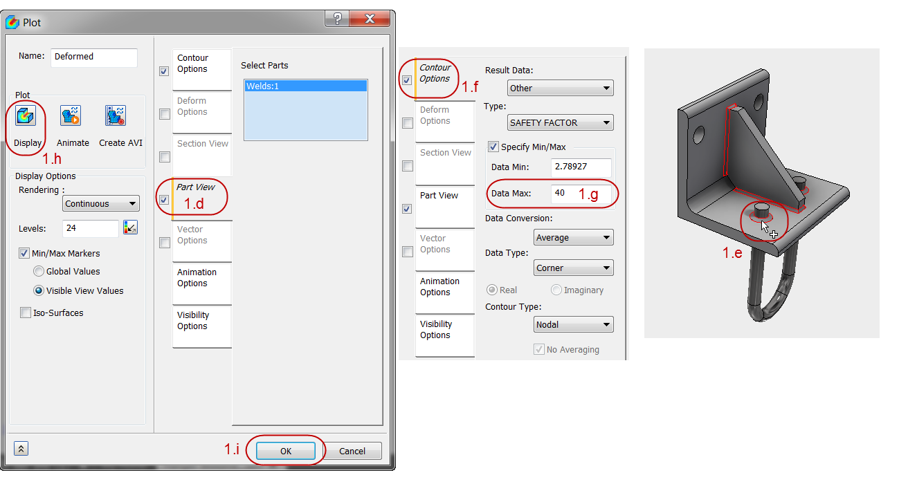

Refer to
Figure 1.d – 1.i
for the following six steps.
Figure 1.d – 1.i
Click on the
Part View tab of the
Plot
dialog box.
In the model canvas, click on one of the weld beads to select the Welds part. The part name appears in the
Selected Parts
list within the
Plot
dialog box.
Click on the
Contour Options tab of the
Plot
dialog box.

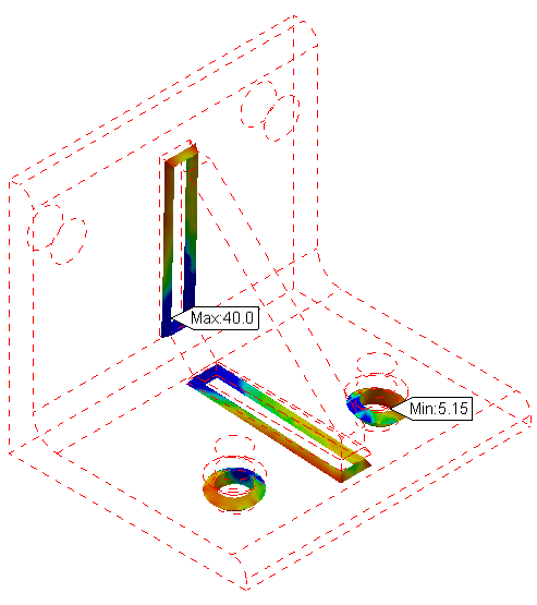

Once again, type
40 into the
Data Max input field. (Reducing the number of displayed parts reset the data range.)
Click
Display. Zoom in for a better view of the welds if desired. Your safety factor contour plot should be similar to the following image:
Click
OK to exit the
Plot
dialog box.
