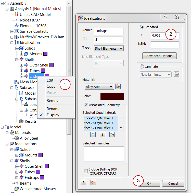

2. Thicken the End Caps and Bulkheads

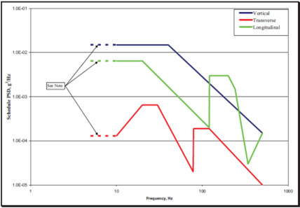

The 380 Hz and 410 Hz modes are very near the drop off region in the road load longitudinal curve. Pushing these modes up 20 to 25% could reduce their sensitivity to this frequency. We can thicken the bulkheads and end caps to shift these modes.
  1. From the Analysis tree, right-click on Endcaps from the Idealizations list, and click Edit.
  2. Change the thickness, t, to 0.062.
  3. Click OK.

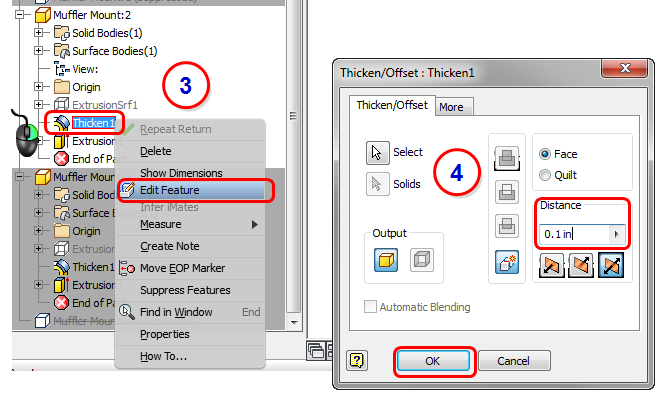

3. Thicken the Mounting Brackets
Similarly, the 102 Hz mode is close to the drop off in the road load transverse curve. This would require a 200-330% increase to justify the change. However, increased material thickness on a small part will have a minor cost impact.
  1. Click Finish Autodesk Nastran to return to the model edit environment in Inventor.

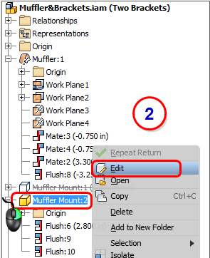

  2. Right-click on Muffler Mount:2, and select Edit.
  3. Right-click on Thicken1, and select Edit Feature.
  4. Enter a Distance of 0.1, and click OK.

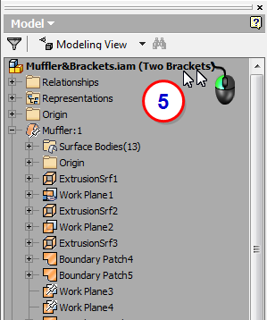

  5. Double-click on the top branch: Muffler&Brackets.iam (Two Brackets).
  6. Repeat steps 2-5 to change the thickness of Muffler Mount:3 to 0.1.

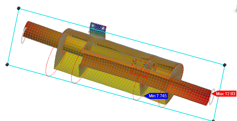

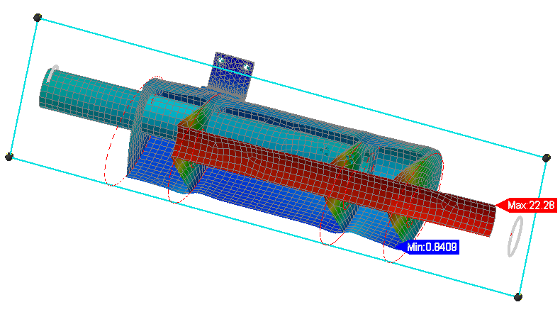

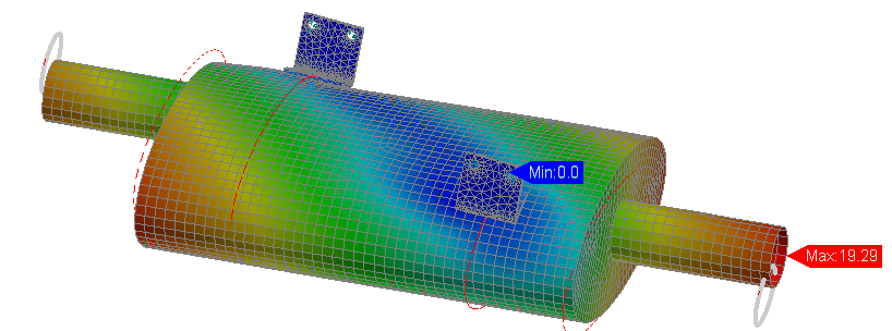

We can see that the longitudinal modes were pushed exactly where they needed to go to minimize the possibility of vibration-related failure.
Mode 1:
Mode 2:
Mode 3:
