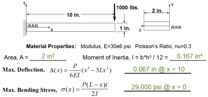

In this exercise, we will simulate a simple cantilevered beam with a fixed end and a load applied to the other end. Here is the basic process:

These are the assumptions we will use for this simulation:
- The displacement is small.
- The material exhibits a linear stress-strain response.
- The applied load does not change in magnitude, orientation, or distribution.
- The effects of gravity are negligible.

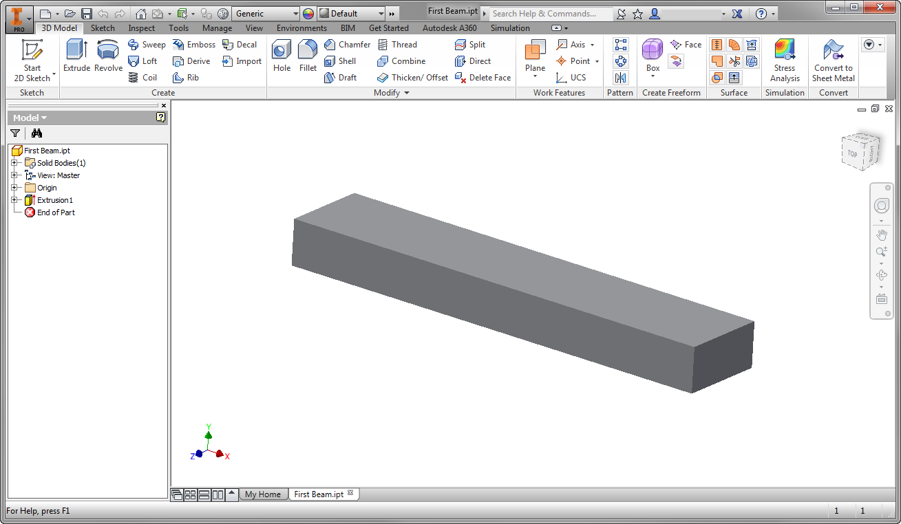

1. Open the Model
Start Autodesk Inventor, and open
First Beam.ipt from the
Section 3 - Cantilevered Beam sub-folder of your training exercises folder. You should see this, although the Model pane on the left might not be visible:

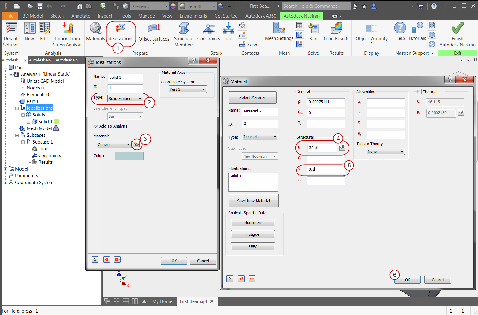

3. Assign the Physical Property
- Click
Idealizations from the ribbon.
- On the Idealizations dialog, confirm the
Type is
Solid Elements.
- Click the
New Material icon.
- On the Material dialog, enter
30e6 for
E (Young's Modulus).
- Enter
0.3 for
v (Poisson Ratio).
- Click
OK on the Material dialog.
- Click
OK on the Idealizations dialog.

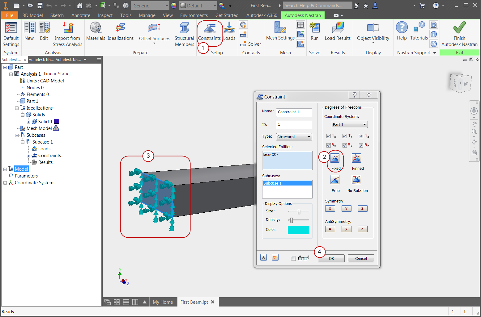

4. Constrain the Beam
In this step, we assign the condition that fixes the beam on one end, preventing movement in any direction.
- Click
Constraints from the ribbon. Click and move the
View Cube in the upper right of the Inventor window to reposition the beam so you have a clear view of one end.
- On the Constraint dialog, click
Fixed. (This is the default setting.) Under
Display Options, you can also use the
Density setting to control the number of constraint symbols that will appear in the image.
- Click the end of the beam, as shown in the image.
- Click
OK.

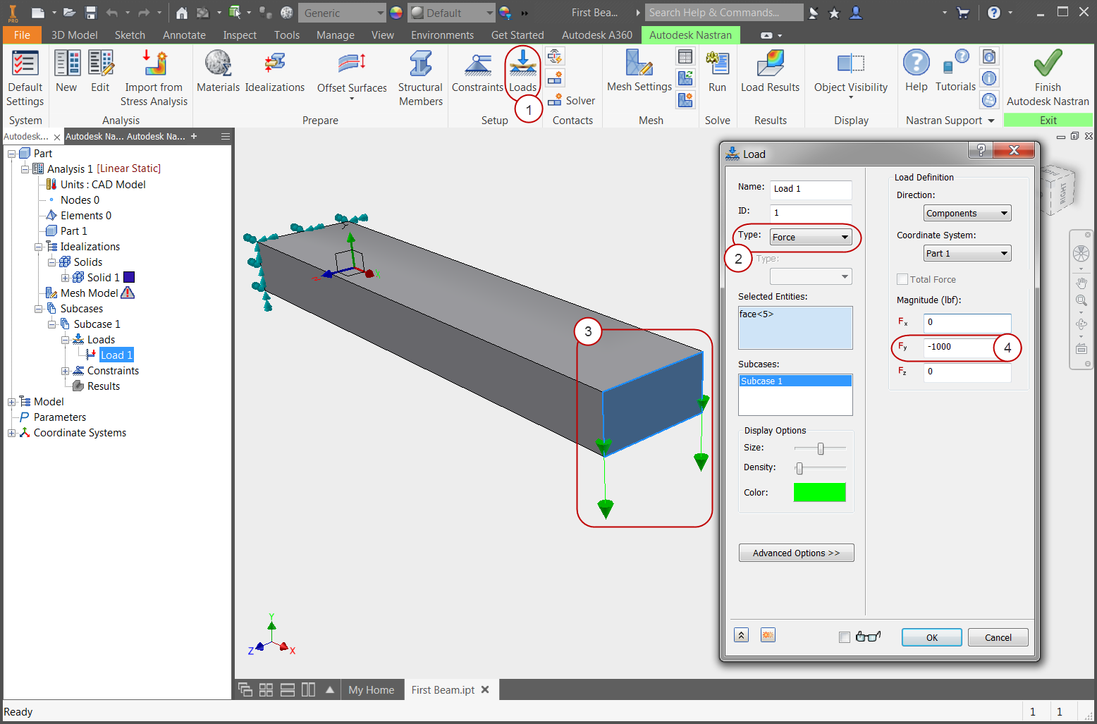

5. Load the Beam
- Click
Loads from the ribbon.
- Note that
Force is the default
Type of load.
- Select the end of the beam that does not have the constraint (as shown).
- Enter -1000 for
Fy.
- Click
OK.

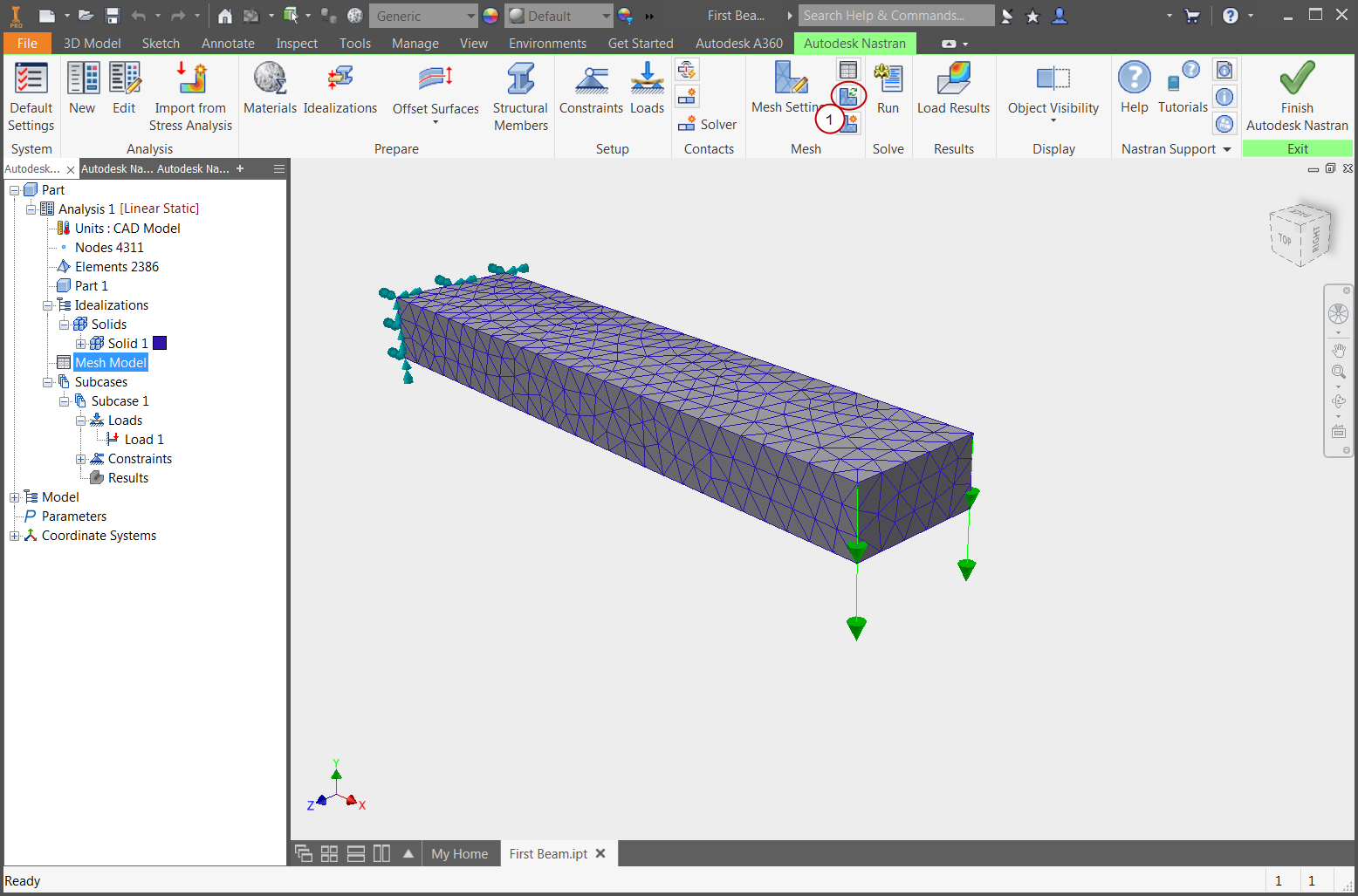

6. Mesh the Beam
- Click
Generate Mesh from the ribbon.
The mesh generates:

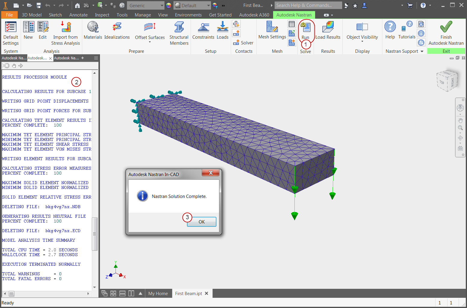

7. Run the Simulation
- Click
Run from the ribbon.
- The tree automatically switches to the Autodesk Nastran output. This is a log of the solution progress.
- When the solution is complete, click
OK.

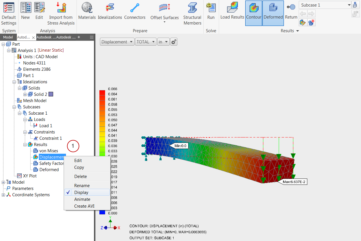

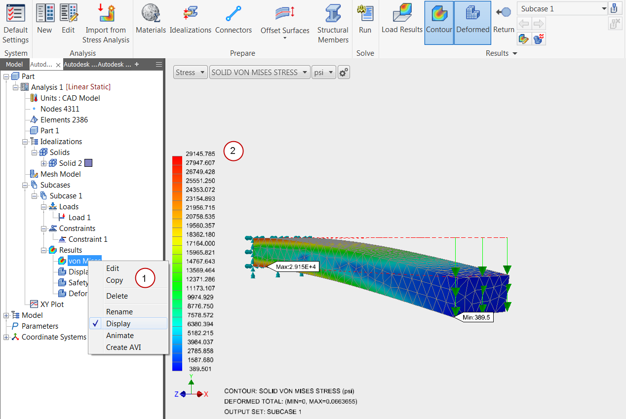

8. Visualize Displacement
- If the Analysis tree is not visible, click on the
Autodesk Nastran Model Tree tab.
- Under the
Results node of the tree, right-click
Note the maximum displacement of
0.066 inches.
9. Visualize Stress
- Under the
- Note the maximum stress of
29,000 psi.

When we compute the response by hand, we find the following:
