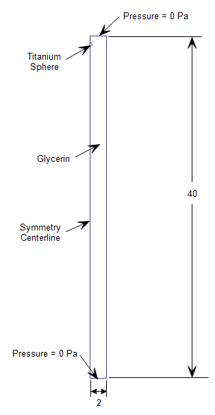

Problem Description
In this test model, a titanium sphere is dropped through a column of glycerin. The Motion capability is used to predict the terminal velocity of the sphere.

Geometry and Boundary Conditions
All dimensions are in meters:
The model was solved as axisymmetric.
