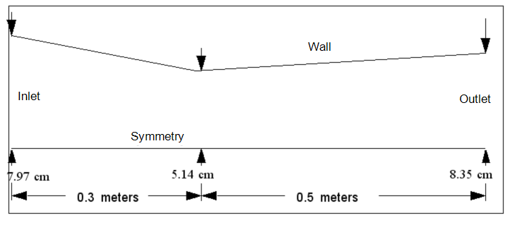

Problem Description
Compressible flow through a converging-diverging nozzle is a classic fluid mechanics problem. For ideal flow (no friction), shockless and choked conditions, there are analytical expressions for determining the exit Mach number, pressure and temperature.
For this verification analysis, the inlet conditions are set so that the flow is choked and the Mach number at the throat is 1.0 for ideal flow conditions. Friction is included in the analysis, so the interaction between the boundary layer and the supersonic flow in the diverging portion is apparent.
Outlet conditions predicted by Autodesk® CFD are compared to values predicted using ideal flow theory.
Geometry and Boundary Conditions
