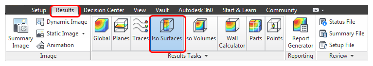

In this step, we create a three dimensional view of the flow and temperature results.
1. Click Results > Results Tasks > Iso Surfaces.
2. Click Add from the Iso Surfaces context panel.

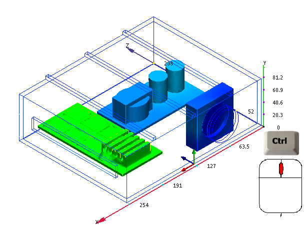

3. If the casing is not showing, resume it by holding Ctrl and middle clicking anywhere off the model.
