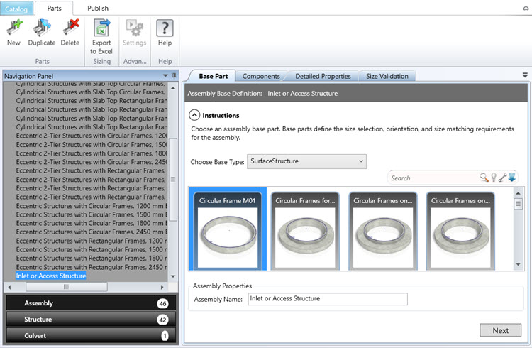

  1. Open the Parts Editor.
  2. Open a Drainage Structure or Piping catalog.
  3. Select an assembly name in the Navigation panel.
    • For a Drainage Structure this will be an Inlet or Access Structure assembly, or a Culvert assembly.
    • For Piping, this could be a Fastener, Fittings, Flange, Instruments, Olets, Pipes, Valves and Operators, or Miscellaneous assembly type.
  4. Right-click.
  5. Click New or Create Assembly.
    A generic assembly matching the assembly type you selected is added to the catalog. For example, in the Drainage Structure domain, an "Inlet or Access Structure" or "Culvert" assembly is created, depending on your selection.
  6. Input a name for the new assembly.
  7. Choose a base part family.

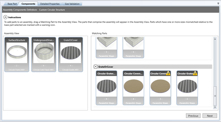

  9. Drag and drop Matching Parts families into the Assembly View.
    Unlike Inlet or Access Structure assemblies, Culverts assemblies will allow 'None' as a valid End Treatment condition
    Note: Parts with one or more sizes mismatched relative to the base part selected are marked with a warning icon.

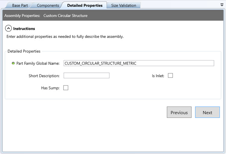

  11. Configure detailed properties.
    If the Assembly is an Inlet, checkmark Is Inlet.
    If the Assembly has a Sump, checkmark Has Sump.

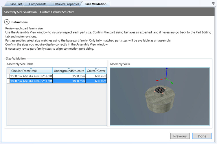

  13. Use Size Validation to visually inspect each part size.
  14. Click Done.
