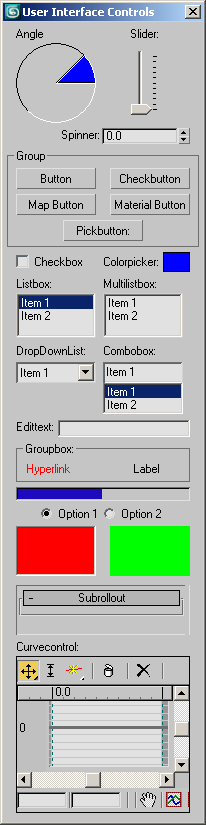

以下のリストにロールアウトの作成に使用できるユーザインタフェース コントロール タイプを示します。
angle
slider
spinner
button
checkbutton
mapbutton
materialbutton
pickbutton
checkbox
colorpicker
listbox
multilistbox
dropdownlist
combobox
edittext
groupBox
hyperLink
label
progressbar
radiobuttons
bitmap
imgTag
SubRollout
curvecontrol
popUpMenu (表示されません)
timer (ロールアウトには表示されません)
イメージマップとして使用した上のロールアウトの作成には、以下のスクリプトを使用しました。
スクリプト例:
try(destroyDialog allControls )catch()
rollout subRollout1 "Subrollout" ( )
rollout allControls "User Interface Controls" (
angle theAngle "Angle" width:80 across:2 degrees:45 align:#left
slider theSlider "Slider:" orient:#vertical
spinner theSpinner "Spinner:"
group "Group" (
button theButton "Button" across:2 width:80 align:#left
checkbutton theCheckbutton "Checkbutton" width:80 align:#right
mapbutton theMapButton "Map Button" width:80 across:2 align:#left
materialbutton theMatButton "Material Button" width:80 align:#right
pickbutton thePickbutton "Pickbutton:" width:80)
checkbox theCheckbox "Checkbox" across:2 offset:[0,2]
colorpicker theColorpicker "Colorpicker:"
listbox theListbox "Listbox:" items:#("Item 1","Item 2")\
height:3 width:80 across:2
multilistbox theMLBox "Multilistbox:" items:#("Item 1","Item 2")\
height:3 width:80
dropdownlist theDDL "DropDownList:" items:#("Item 1","Item 2")\
width:80 across:2
combobox theCombobox "Combobox:" items:#("Item 1","Item 2")\
height:3 width:80
edittext theEdittext "Edittext:"
hyperlink theHyperlink "Hyperlink" url:"http://www.autodesk.com"\
color:red across:2 offset:[10,20]
label theLabel "Label" offset:[0,20]
groupBox theGroupbox "Groupbox:" height:40 offset:[0,-40] width:174
progressbar theProgressbar "Progressbar:" value:50
radiobuttons theRadiobuttons labels:#("Option 1","Option 2")
bitmap theBitmap "Bitmap" width:80 height:50 offset:[0,0]\
bitmap:(bitmap 80 50 color:red) align:#left across:2
imgTag theImgTag "Bitmap" width:80 height:50 offset:[0,0]\
bitmap:(bitmap 80 50 color:green) align:#right
SubRollout theSubrollout "Subrollout" height:50
curvecontrol theCurvecontrol "Curvecontrol:" height:150
createDialog allControls 200 800
AddSubRollout allControls.theSubrollout subRollout1
