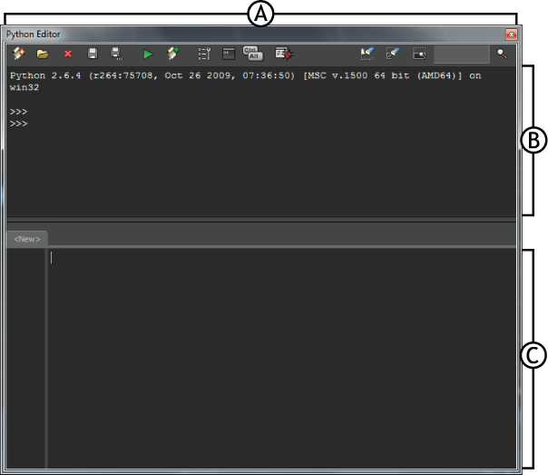

The MotionBuilder Python Editor is accessed under Window > Python Editor. This editor is a convenient place to write and run Python programs for MotionBuilder. The Python Editor (as shown below) is composed of three major sections.
