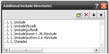

To use pyfbsdk within your plug-in, include the directories for pyfbsdk, Boost and Python to the Additional Include Directories:

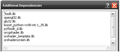

In addition, include the 'boost_python-vc90-mt-1_35.lib' , 'pyfbsdk.lib' to the Additional Dependencies within your project settings:
