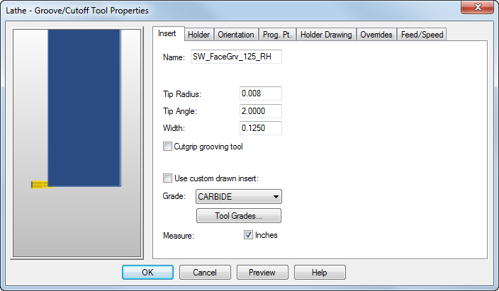

Click the tool preview image to pan and zoom it. The orientation of the preview is determined by the Machine tab settings of the Viewing Options dialog. Right-click the image to access a context menu.
Name — Enter a name that identifies the tool. The name must be unique among all the tools in the crib.
Tip Radius is the radius of the cutting tip of the insert.
Width is the width along the Z axis of a grooving/cutoff tool.
Measure — This indicates the units that are used for reporting the tool’s dimensions. Select Inches for inch units or deselect it for millimeters.
