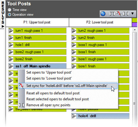

In this example, we want the hole4.drill operation on the Lower tool post to run before the main_off off Main spindle operation on the Upper tool post:
  1. Select the operation that you want to run first, in this case hole4.drill.
  2. Press and hold the Ctrl key and, from the other column, select the operation that you want to run next, in this case ss1 off Main spindle.
  3. Right-click on either of the selected operations and select Set sync for 'hole4.drill' before 'ss1.off Main spindle'.

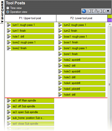

    A red line is displayed in the list to show the sync point. hole4.drill is above the sync point and ss1.off Main spindle and all subsequent operations are displayed below it.
