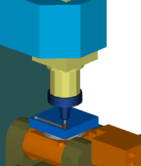

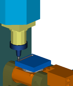

For example:
With an orientation angle of 0, the groove is cut in the machine's Y direction.
With an orientation angle of 90, the groove is cut in the machine's X direction.
This option only applies if the machine tool starts at the singularity (where the machine tool's Z-axis is aligned with the setup's Z-axis). If the machine tool is not at the singularity, you can specify the C-axis orientation using these methods:
