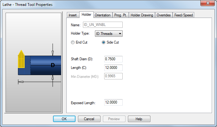

Click the tool preview image to pan and zoom it. The orientation of the preview is determined by the Machine tab settings of the Viewing Options dialog. Right-click the image to access a context menu.
Name — Specifies the name of the current tool.
Holder Type — For threads possible holder types are:
End Cut — The tool cuts in a direction parallel with the length of the holder.
Side Cut — The tool cuts in a direction perpendicular with the length of the holder.
Exposed length — This is the amount of the tool that sticks out of the holder if the holder is simulated.
