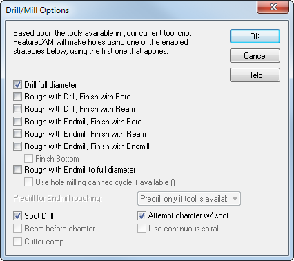

You can use the Drill/Mill Options dialog to edit the feature-level drilling and milling options.
To display the Drill/Mill Options dialog, select Drill/Mill on the Strategy tab of the Hole Feature Properties dialog, then click Drill/Mill Options.
Select the strategies that you want to enable. The options are:
If you select more than one strategy, FeatureCAM works down the strategy list in the dialog until it finds a strategy that can complete the hole.
Spot Drill — Enable this option to add a spot drill operation to the Hole feature.
Attempt chamfer w/ spot — Enable this option to try to cut the chamfer during spot drilling. If no available tool can spot and chamfer without gouging the hole, a separate chamfer operation is created.
Ream before chamfer — Enable this option to do the Ream operation before the Chamfer operation. This avoids pushing any kind of burr or edge back up onto the chamfer if the chamfer is a sealing surface.
Cutter comp — Enable cutter compensation for milled holes.
Use continuous spiral — Select this option to use an NT Continuous Spiral toolpath, which eliminates nearly all stepovers.
