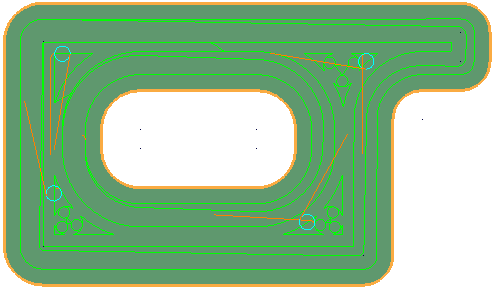

When using the Profile Group Parameters dialog for a Pocket Mill strategy, the following settings are available:
Style — Select the style you want to use to machine the pocket:
Optional Pass — Select an option to specify whether you want a clean-up pass to be performed for this toolpath. As PartMaker automatically detects where material is left and generates clearance toolpaths accordingly, it is unlikely that a clean-up pass will be required. However, the option has been retained for compatibility with PartMaker v2013 and earlier.
Toolpath Direction — Select an option to specify the direction of the toolpath. This option is applicable only for Spiral pockets.
Z_Surf (S) — Enter the signed distance from the zero reference point to the part surface.
Z_Depth (D) — Enter the depth of the operation to be performed.
Z_Rapid (R) — Enter the distance between the bottom tip of the tool and the part surface when a tool performs rapid moves.
Z_Clear (Cl) — Enter the distance between the bottom tip of the tool and the part surface when a tool starts feeding into the part.
Bottom Finish (b) — Enter the amount of material left on the bottom for finishing if the Finishing option is selected.
Wall Finish (w) — Enter the amount of material left on the wall for finishing if the Finishing option is selected.
Angle (a) — Enter the angle of the X axis formed by the toolpath in a linear pocket.
Linear Extension (L) — Enter the length of the linear extension that is added from the center of the innermost pass to the start point of the innermost pass, as a percentage of the tool diameter. If you do not require a linear extension, enter 0. This option is available only for spiral pockets where Center Entry is not selected.
Out to In — Select this option if you want the toolpath to start from the outer edge of a pocket, and work inwards, rather than starting from the inside and working outwards. This option is applicable only to spiral pockets where Advanced Milling Toolpath is not selected.
Minimize Air Moves — Use this option to control how the toolpath offsets and minimizes air moves:
This produces a toolpath which minimizes the number of lifts and works extremely well for soft materials.
Each area is machined with one plunge at the start of the toolpath. This works well if cut direction is not important, as it is difficult to maintain cut direction if you are not allowed to lift the tool.
This option increases the number of lifts.
Center Entry — Select so that PartMaker adds a linear extension from the center of the innermost pass to the start point of the innermost pass. This option is applicable only to spiral pockets. It is not available if Out to In is selected.
