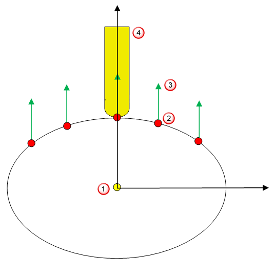

Tool orientation: Vertical
Orientation angle (A): 0
Rotary axis
Toolpath point
Tool axis at a given toolpath point
Tool

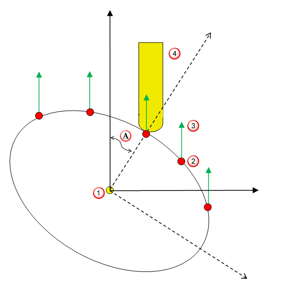

Orientation angle (A): Set to a value other than 0
Rotary axis
Toolpath point
Tool
Orientation angle

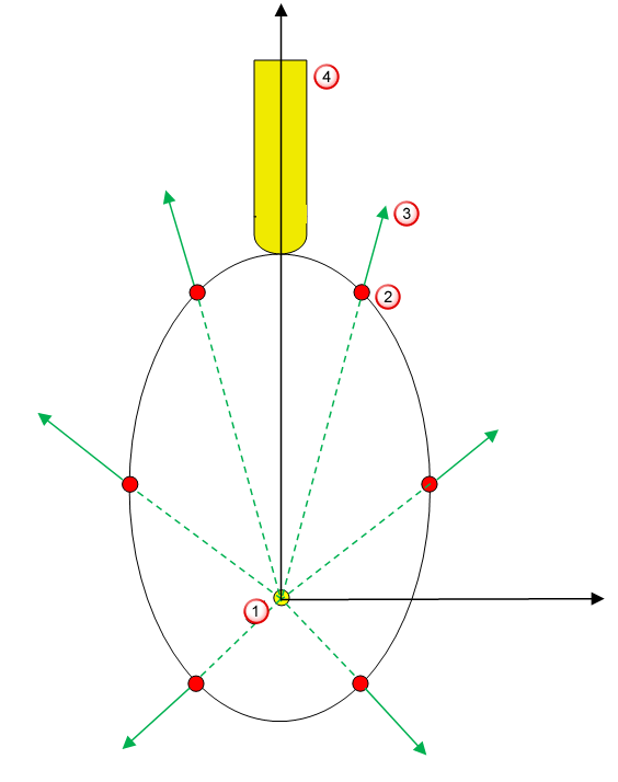

The following image shows the Radial tool axis type in reference to the machining plane:
Rotary axis
Toolpath point
Tool

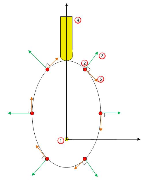

The following image represents the Towards surface tool axis type at a cross-section plane parallel to the machining plane:
Rotary axis
Toolpath point
Tool
Surface tangent
This option is not available when using the Pattern finishing strategy with a Base position of Drive curve.

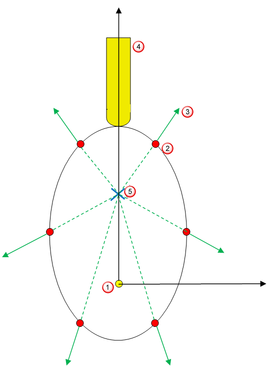

The following image represents the Towards spine tool axis type at a cross section plane parallel to the machining plane:
Rotary axis
Toolpath point
Tool
Intersection of spine curve with the cross-section plane
