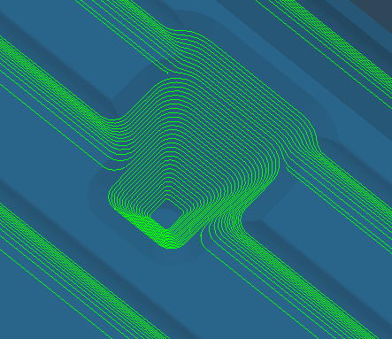

Use the Unsafe segment removal page to remove small toolpath segments and so prevent tool damage when using non-center cutting tools. When machining into small pockets, removing small segments stops the central, non-cutting underside of the tool from hitting non-machinable material. Unsafe segment removal filters out the machining of confined areas with small movement of the cutting tool.
Remove segments smaller than threshold — Select this option to remove segments that are smaller than the Threshold value.

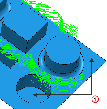

— Areas where segments are removed as these segments are smaller than the Threshold value.
If segments are smaller than the threshold value but surround a boss they are not removed.
Threshold (tool diameter units) — Enter the size against which all segments are compared. The higher the threshold value, the more segments are removed.

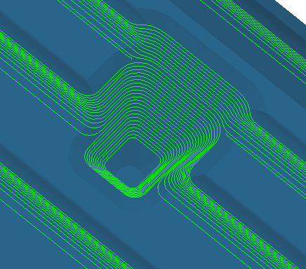

Only remove segments from enclosed areas — Select this option to remove segments, in enclosed areas, that are smaller than the Threshold value.
Areas where segments are not removed as these segments are not in an enclosed area even though they are smaller than the Threshold value.
