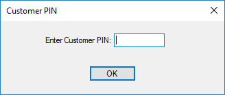

on the Main menu to display the Customer PIN dialog.

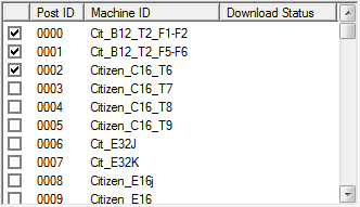

All the Post files that are available to your organization are displayed in the Post Files area of the dialog.
By default, the Post files are sorted by their Post ID. Click Machine ID to sort the Post files by their Machine ID.
Double-click on a Post file to view the latest release information about that file in the Latest Release Info area of the dialog.

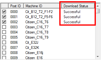

When the download is complete, PartMaker updates the Download Status column. For example:
If you wish, you can click Open Folder to open the folder containing the downloaded files.
