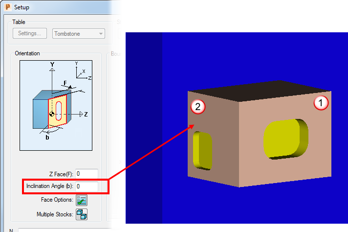

When you define the Face plane of a 4-axis dependent face on a tombstone table from the solid model (using Solids > Face Coordinate System > Define Face Plane), PartMaker automatically calculates the inclination angle for the dependent face and displays this value in the Inclination Angle field on the Setup dialog. For example, the FRONT independent face shown below is specified at an Index Angle of 0 degrees. When defining the Face plane of a 4-axis dependent face from the solid model, PartMaker calculates that this face needs an inclination angle of -90 degrees from the FRONT stock work side.
Independent face (FRONT)
Dependent face

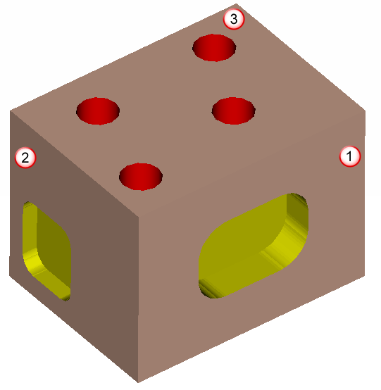

Stock Orientation in Multiple Stock Machining — Using the settings in this area of the dialog, you can specify different Face windows for different sides of the box and program them in the orientation needed to produce the NC code required to reflect how things will be set up on the table. Setting these options also enables PartMaker to connect the machining functions together to show the correct finished part when using PartMaker simulation.
Local Coordinate System
Each part must include a Face window with a FRONT orientation.
FRONT
LEFT
TOP

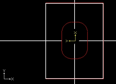

Stock Positioning Angle on Machining Table — Select an angle to specify how stock for the Face window is oriented during machining when compared to finished part. The value you select does not affect the NC code, but PartMaker uses this value to rotate the toolpath during simulation. If you are rotating the part to 90 or 270 degrees, you also need to adjust the coordinates of the boundaries in the Setup dialog.
The following example shows the FRONT Face (shown above) programmed at a +90 orientation with respect to the solid model, so you need to select a value of 90 degrees as the Stock Positioning Angle on the Machining Table. The yellow coordinate system shows the solid model's origin, while the white coordinate system shows the programmed coordinate system. When transferring geometry from a solid model, it is transferred in the programmed coordinate system.
